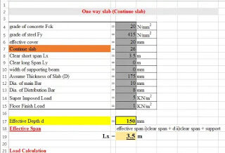

Spreadsheet to Design One Way Solid Slab
The solid slab called One way slab when the aspect ratio for each panel is greater or equal to two: 2.0
The slab is therefore supported by the beams which are supported by columns or by girders.
Analysis and design of 1-m slab strip is then performed in the main direction and the design results are generalized allover the slab.
Minimum shrinkage (temperature) steel is provided in the other direction. The slab strip model is a continuous beam where the supports are beams.
Coefficient method of analysis is used if its conditions are satisfied.
Standard flexural RC design methods are used to determine the required reinforcement.
with this excel sheet you will easily design one way slab with given data of dimension and concrete materials.
