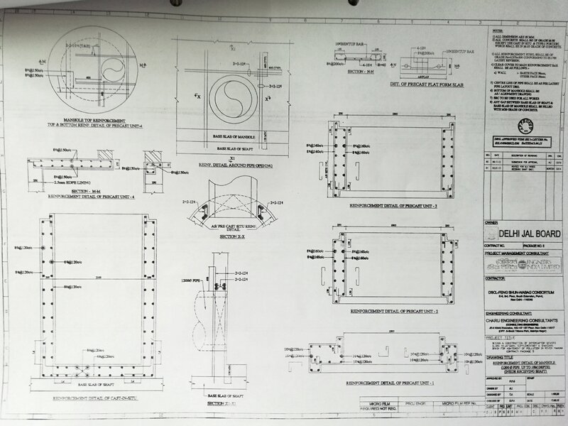

Any one has Structural design report for RCC Manholes ?

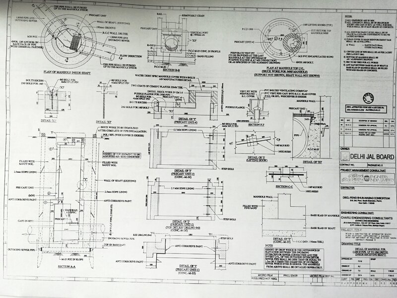

I have attached 2 drawings of Manhole structure
