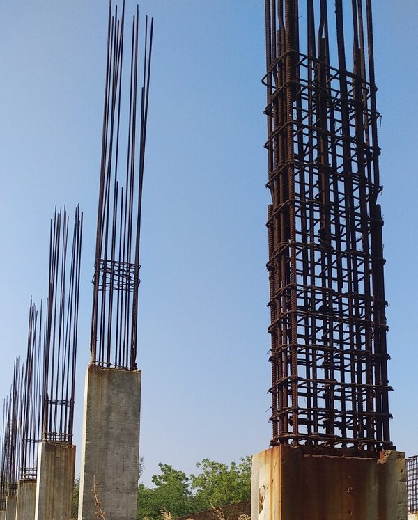

Answered Any solution for such kind of rusted steel??

Rusting is treated as good for bonding between steel and concrete as long as there is no scaling on reinforcement bars.
If the scaling of reinforcement bar seen, it indicates the heavy rusting of steel happened and you need to clean it out in order to ensure bonding of steel concrete.
You can remove the rust by using rust remover spray which is available in market, you can also get done this job manually by deploying labours.
From your picture it look like scaling of reinforcement happened and you need to remove all rust from them before concreting.
To avoid such scenario, if you know the concrete above that level is going to happen after a long time, you should get those bar coated with Anti-Rust coating which will prevent its rusting.
=what is the meaning of scaling on bar
scaling is like deterioration of steel bars into a small parts which looks like a boiler scaling / flakes.
If you find the steel bars are rusted, just grip the bar and then check your palm, if you find small steel bar particle along with rust stuck on your palm, it means scaling of bar happened.
