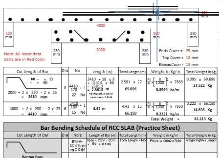

I have created a Bar bending Schedule format in excel sheet, which can be used for followings;
Taking approval from Client or Engineer Incharge - Its a Certificate which allow workmen to do work accordingly.
Ordering the required reinforcement steel Quantity.
Issuing Steel bars to contractor as per BBS and avoiding overdoing and wastage.
Reconciliation of done work and identifying the issues in cutting and bending of steel.
It does a great help to fitter to do cutting and bending as all dimensions and cutting length already provided to them in BBS.
It increases productivity of reinforcement workmen and hence reduce the delays in construction activities.
enclosed herewith a sample of bar-bending schedule for the slab
