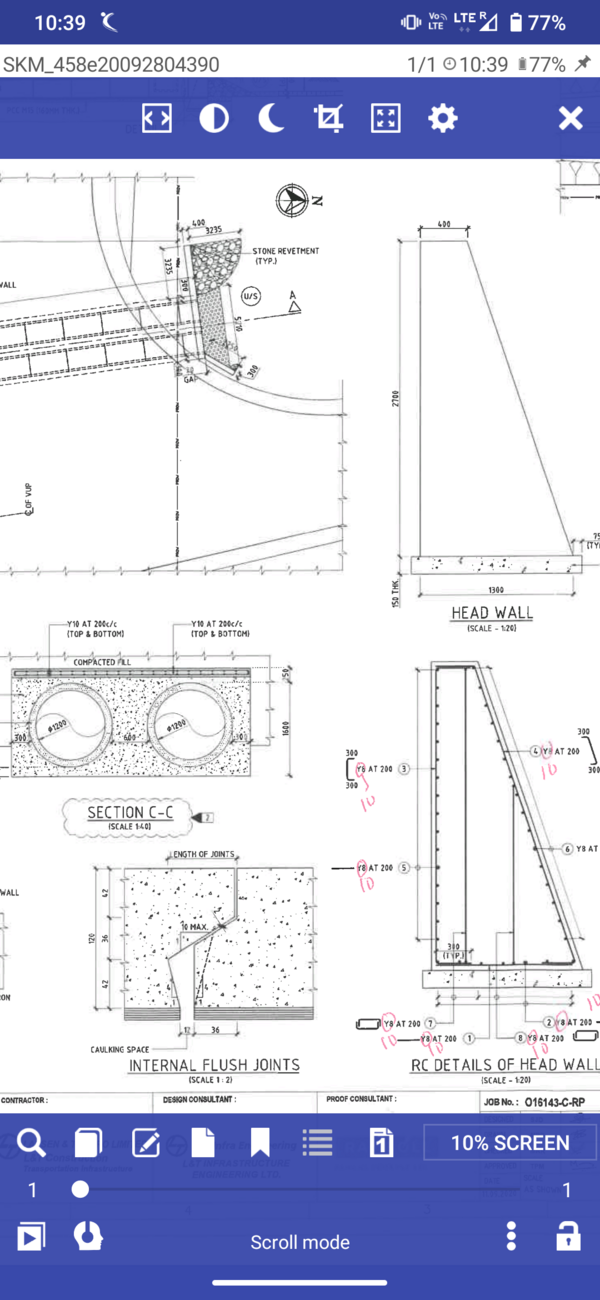

I want to estimate the Steel quantity required for head wall in a pipe culvert but I I was facing difficulty when it comes to the pipe portion at where varying length of Steel will have to be prepared and I want to find out length in the portion
Please find attached file for your reference

I don't understand what you replied but what I'm saying is that if we just remove the pipe portion from the head wall with no reference to location doesn't it gonna affect the numbers and as well as spacing of the bars
And also converting back to weight is not solve the varying length rebar issue

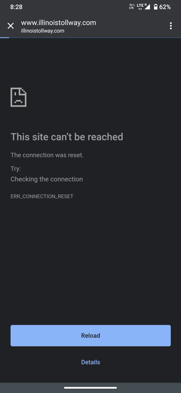

I think it is because of the region I'm not getting access to this website I even used vpn, proxy but none of them are helpful
So can you please send me the file contains the drainage details instead of website link
It would be helpful and I wouldn't have asked if it is not important.
