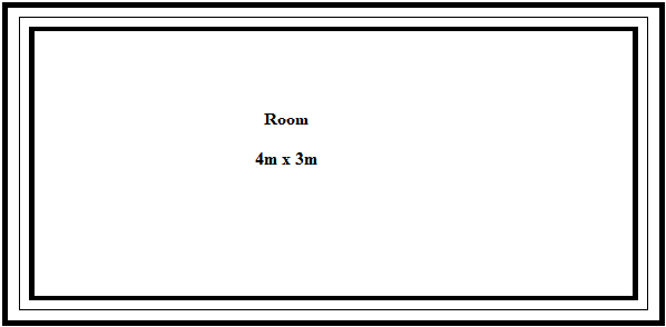

Lets understand this method by one simple example :
Lets assume thickness of wall 0.9 m
Centre line length of horizontal wall = 4 + 0.45 + 0.45 = 4.90 m
Centre line length of vertical wall = 3 + 0.45 + 0.45 = 3.90 m
Total length of centre line = 2 (4.90 + 3.90) = 17.6 m

Lets take one example (Refer above figure) :
Length of long wall (horizontal walls) = 4 + 0.9 + 0.9 = 5.8 m
Length of short wall (Vertical walls) = 3 m (because in to in measured length)
Quantity of excavation for foundation = 2 x (5.8 x 0.9 x 1.2) + 2 x (3 x 0.9 x 1.2) = 19.01 m³
