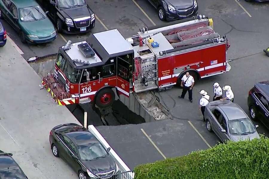

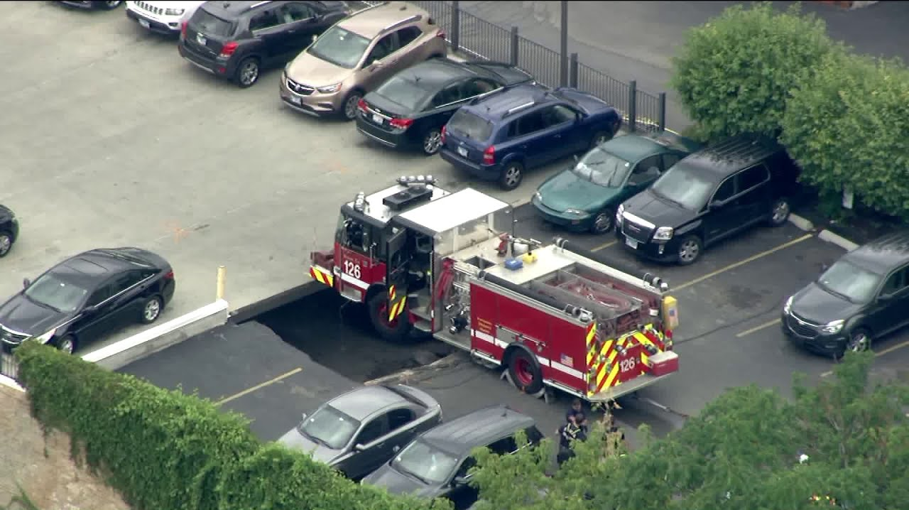

So with that in mind, I think it's healthy to consider a few observations from the images provided by news agencies combined with some deductive engineering reasoning:
--Take a look at the structure that the truck was sitting atop of: It does not appear to be the garage structure but a vaulted slab adjacent to the garage (you can see the perimeter CIP concrete walls in the back of the collapsed area)
--Take a look at the broken roof slab concrete planks in the vaulted area - These are most-likely hollow-core type precast spandrel planks
--Take a look at the the location of the failure - It's right in the middle of the span
--Take a look at where the front wheels of the truck are relative to how many of the planks failed. It wasn't just one or two but numerous planks.
--Take a look at the bearing areas where the planks used to sit on the concrete vault walls: How large of a bearing area existed? Are the planks tied to the walls or are they held by gravity-load only? Did the planks fail mid-span or did they fail at the bearing areas?
I've included a news link - Check out the video, it will give you some additional perspective on the incident. I will monitor this event on behalf of the membership - As details about the causation bear out, I will post updates on this thread - Cheers!!!
