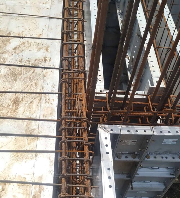

When such a problem arises consultant gives bracket beam in form of U bars which comes out of the column. Therefore in that case half beam will be supported on the bracket and half on the column. This bracket beam can be clearly seen in the pic sent by Mr.Deshmukh.
