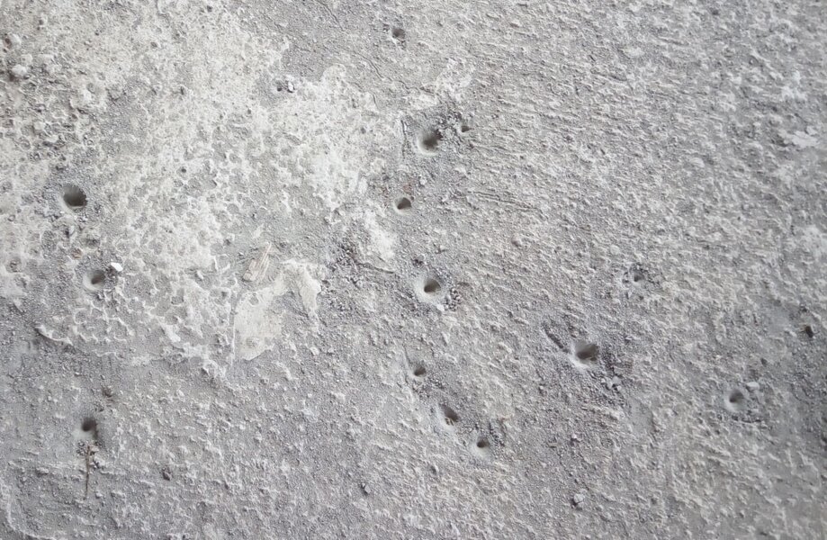

Recently i observed this antlion making their pits on surface of concrete.
 alt=
when lot of fine deposit on concrete surface available, it make them easy to get on it.

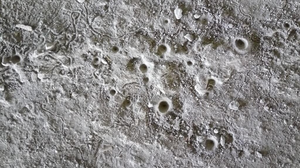

and once they make their homes, they spread everywhere even if the sandy surface is not available.  alt=
Those are like cancer to concrete and need to be treated immediately before it makes a complete damage to concrete surface.

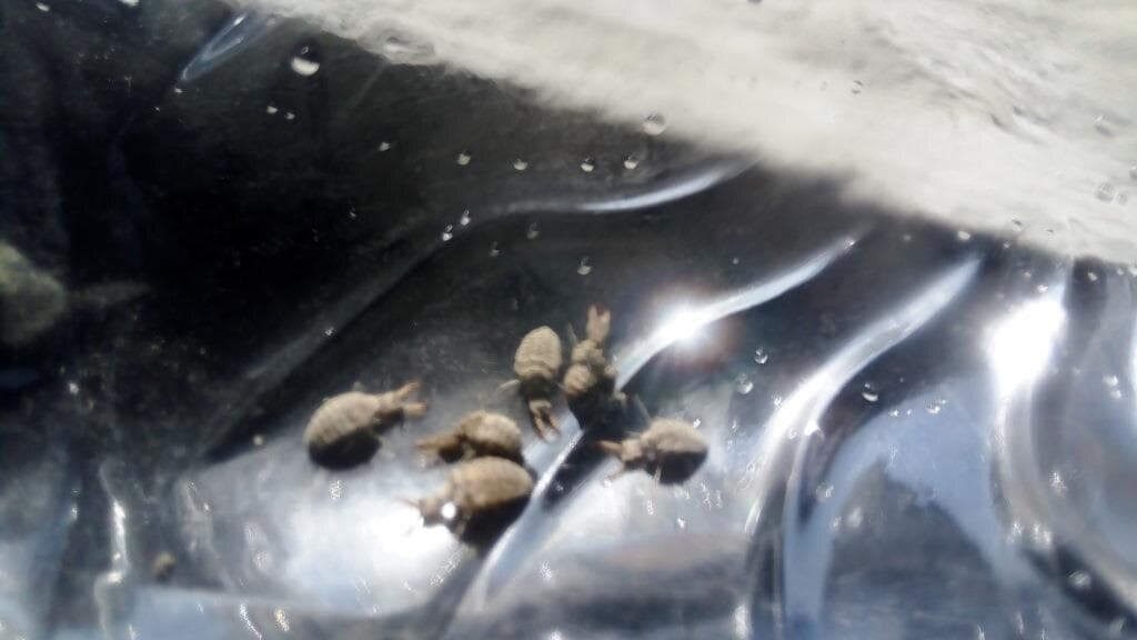

we tried to find those antlion by taking out loose material from that small pit and also by making action like their food is trapped in pit, on first day we did not see any antlion.
After that we searched for more details of it and came to know that antlions camouflage and they act like as they are dead and make roll of their body to look it like a sand particle.
On next day we removed a loose particles from pit and waited there, after sometime the antlion which was sitting there like a dead in form of sand particle, began to crawl.
We also took them out by pouring water in pit. we collected some good amount of antlion insect and took photo of it.
 alt=
We also experimented a solution to kill those antlions, we poured a waste oil drops in those pits and the antlion become dead.
