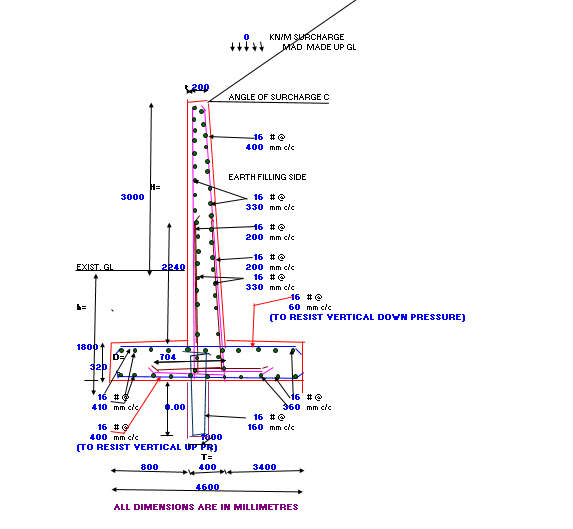

Designing of retaining wall based on B C Punmia Vazrani and Ratwan
with the help of attached excel sheet you will able to design many types of retaining walls in RCC as well as in brick masonry.
the excel sheet for designing of retaining wall is attached below, click on attachment for downloading.
