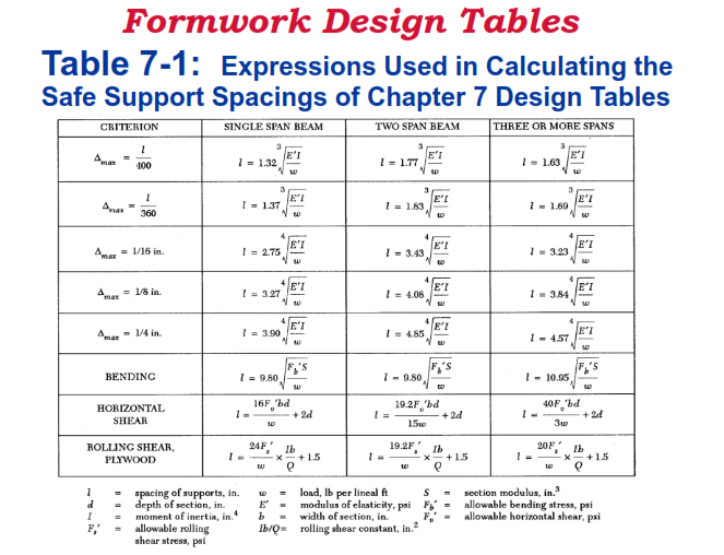

Table 7-1 shows the expressions which are used to calculate the safe support spacing's (spans).
