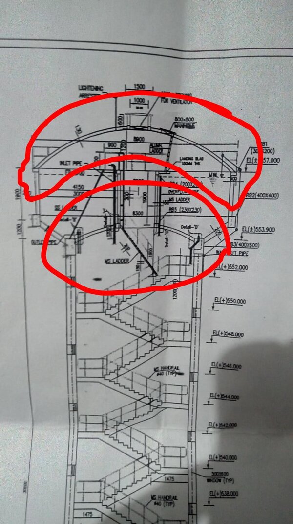

narasimhulu Newbie tirupathi Feb 8, 2018 #1 Please explain the Concrete and steel quantities for dome portion which is marked below Reactions: Er Kishore kumar

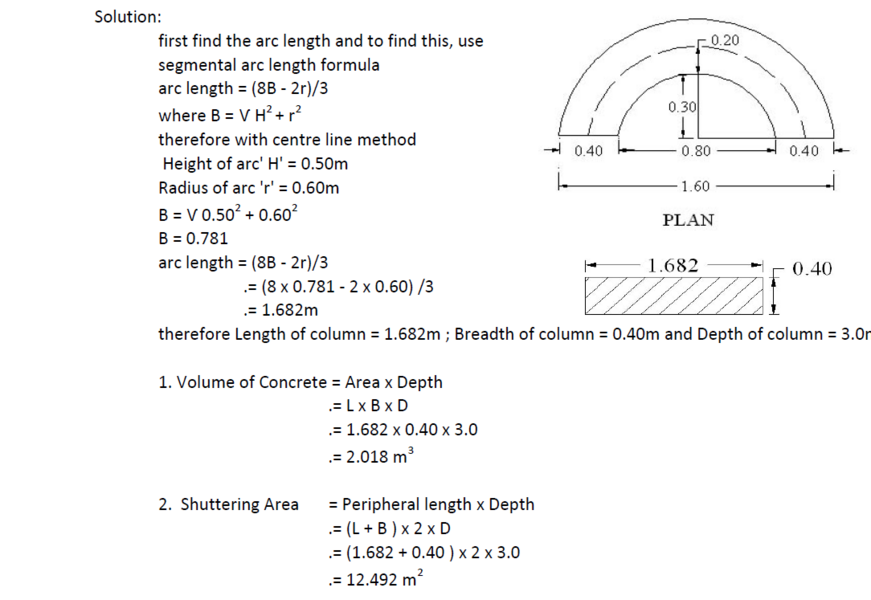

archdevil Royal Member India Feb 8, 2018 #2 follow the rules as shown below the sample Reactions: Ammaiyappan, Chittaranjan Dash, Er Kishore kumar and 2 others Upvote 0 Downvote
archdevil Royal Member India Feb 8, 2018 #4 same methodology.prepare a bbs and you will come to know the same Upvote 0 Downvote
