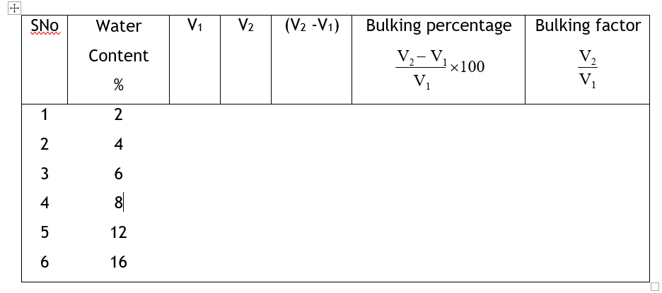

- Take about 200gms of dry sand in a 1 liter jar and find its volume (V1)
- Put the above sand in a mixture pan and add 2% water by weight. Mix it thoroughly to get uniform color.
- Fill this moist sand into the 1 liter cylinder and note down the volume (V2)
- The increase in volume is (V2 -V1) and the percentage of bulking is V2 - V1 ´100 V1
- The bulking factor V2,V1
- Repeat the experiment with different percentages of water i.e., 4,6,8,12,16%
- Plot the graph of bulking factor on Y axis v/s moisture content by percentage of dry mass of sand on X-Axis. This is known as bulking curve.
