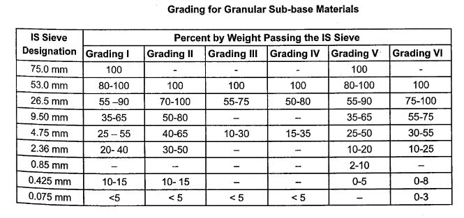

If you refer a Morth Specifications, you will find the data required for assessment of grade of GSB.
Above table shows the requirement of % cumulative passing through each sieve, upon doing sieve analysis and calculating the cumulative % passing.
You can look at the table to determine its grade.
Once the grade either specified or designed to achieve max density (MDD), it is important to verify, received GSB is as per it.
