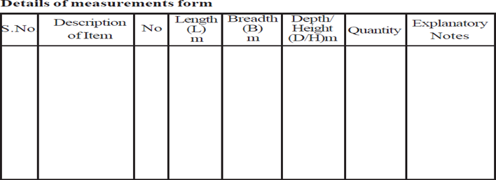

Details of measurements and calculation of quantities
The complete work is divided into various items of work such as earth work concreting, brick work, R.C.C. Plastering etc., The details of measurements are taken from drawings and entered in respective columns of prescribed proforma. The quantities are calculated by multiplying the values that are in numbers column to Depth column as shown below:

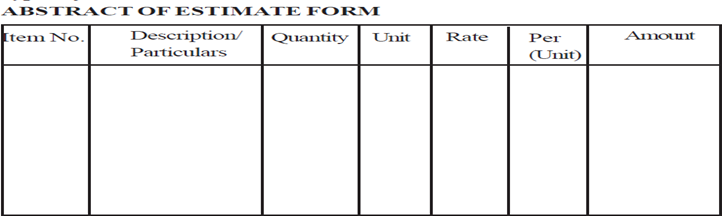

Abstract of Estimated Cost :
The cost of each item of work is worked out from the quantities that already computed in the details measurement form at workable rate. But the total cost is worked out in the prescribed form is known as abstract of estimated form. 4% of estimated Cost is allowed for Petty Supervision, contingencies and Unforeseen items. A percentage of 1.5% to 2% is also added to meet the expenditure of work-charged establishment. The grand total thus obtained is estimated cost of the work.
