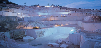

Mining marble blocks from the wall of the quarry starts with a “bench Quarrying.” The bench quarrying creates, bench wall which is a large section of marble along a vertical wall that is cut with diamond cables, drills, and torches.
Marble Quarry
Once mining has begun, there may be several months of excavating before any marble is mined from the quarry. Overload, or dirt on top of the desirable ore, needs to be extracted before blocks of marble can be extracted. Marble blocks are mined from examined marble quarry face (yielding the most favourable blocks).It is required to be supervised each cut made from the quarry; marble mined along the “vein” of the deposit will have a very altered look than marble that is “cross-cut” transversely the vein.

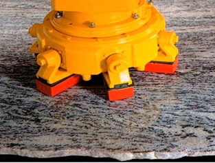

Polishers grind down the naturally rough surface of the stone to multiple finishes the consumer desires. Hard stones like marble and granite can be polished all the way to a mirror finish. The polisher consists of rotating pads which are textured with an abrasive material. The finer and smaller the abrasive grits are, the higher the polish.
Marble Quarry
