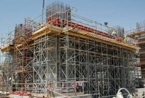

I have attached herewith the presentation on Formwork shuttering and its design along with photographs, the presentation includes following topics;
Formwork is a mould or open box, like container into which fresh concrete is poured and compacted.

It consist detailed information on following;
British Standards Formwork Striking Times
Turkish Standard Formwork Striking Time
Formwork ties specifications and details
Design of Wall and Column formwork
You can download the presentation from below attachment.
