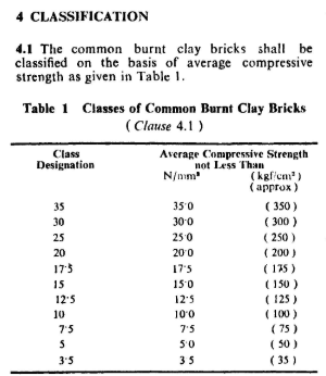

Now see the table below from IS 1077 below for your clarity.
Sorry sir i just misunderstood the question. Thank your for the clarity. Yes, me too referred Table 1 only from IS 1077 where Minimum strength mentioned was 3.5, Though I realize it should be as per Tech spec or BOQ.
