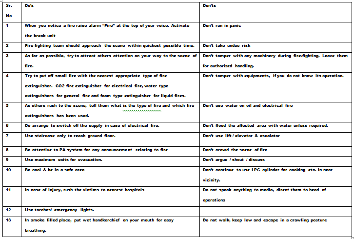

Do’s and Don’ts in case of Fire
Properly display of a tabulated list which broadly indicates Do’s and Don’ts for everybody to assist in combating fire:

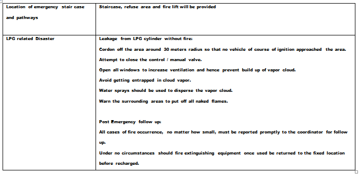

IN CASE OF LPG LEAKAGE:
Immediate Action
- Take immediate steps to stop LPG leakage/fire and raise alarm simultaneously
- Stop all operations and ensure closure of all isolation valves
- As LPG fires develop and spread quickly, so all out efforts should be made to contain the spread of leakage./fire
- Plant personnel without any specified duties should assemble at the nominated place.
- All vehicles except those that are required for emergency use should be moved away from the operating area in an orderly manner at pre nominated route
- Electrical system except the lighting and fire fighting system should be isolated
- If the feed to the fire cannot be cut off, the fire must be controlled and not extinguished.
- Starts water spray system in the areas involved in or exposed to fire risks.
- In case of leakage of LPG without fire and inability to stop the flow, take all precaution to avoid source of ignition.
- Block all roads in the adjacent area and enlist police support for he purpose, if warranted
Action in the Event of fire:
- Basic actions will be as detailed above.
- Extinguishing fire: a small fire at a point of leakage should be extinguished by enveloping with a water spray of a suitable smothering agent such as CO2 or DCP. However, LPG fire should not, unless under exceptional circumstances, be extinguished until the escape of product has been stopped. If escaping vapor cannot be stopped, water should be directed at the point of leakage to assist rapid dispersion. Ensure that static charge is not generated in the LPG vapor clouded- solid jets of water into the cloud should be avoided. Fog nozzles should be used instead.
- Fire fighting personnel working in or close to un-ignited vapor clouds or close to fire, must be protected continuously by water sprays. Fire fighter should advance towards the fire downwind if possible.
- In case the only valve that can be used to stop the leakage is surrounded by fire, it may be possible to close it manually. The person attempting the closure should be continuously protected by water sprays, fire entry suit, water jet blanket etc. The person must be equipped with a safety belt and a manned lifeline. In case of rapid increase in decibel level or lifting sound from a relief valve, evacuate the area as there would have been over pressurization.
- Cordon off the area around 30 meters radius so that no vehicle or source of ignition approach the area. Attempt to close the control manual valve.
- Try to transfer LPG into another vessel if possible.
- Avoid getting entrapped in the cloud vapor.
- Water sprays should be used to disperse the vapor cloud.
- Warn the surrounding areas to put off all naked flames.

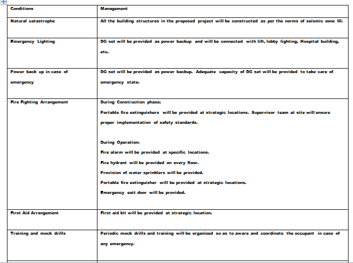

The various provisions for disaster management can be summarized as:
