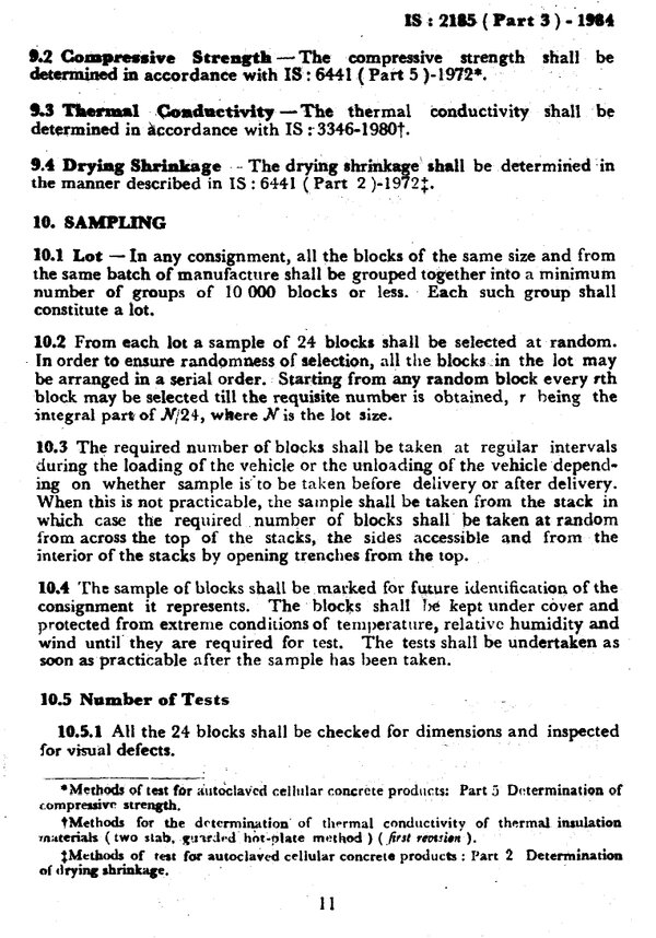

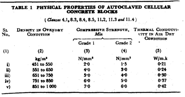

I would suggest you to refer to the IS code ( screenshot below for reference) my emphasis will be more on the Compressive strength, Density, Thermal conductivity, and water absorption.
Based on the compressive strength required by you, check the corresponding densities.
Get the blocks tested from a reputed laboratory so that the 2 or 4 factors which are important to you are verified and authenticated, then it doesn't mind which brand you are using so long as the quality is assured by the vendor. Cheers ;)
