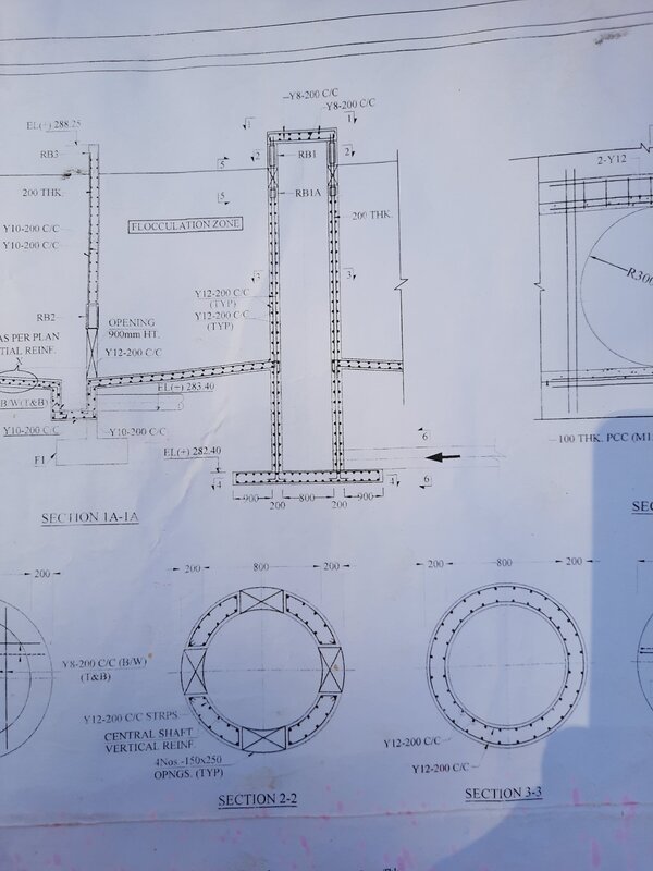

Prabhupada Sahoo Junior Member Bhubaneswar Jan 26, 2021 #1 This is central shaft reinforcement drawing. The placement of Vertical reinforcement and horizontal reinforcement is correct position ? yes or no
