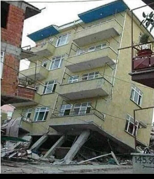

Answered what causes the failure of this structure
ranna
Apprentice
Jun 4, 2019
11
trichy
Slender columns at ground floor level caused the failure
This failure may be because of horizontal load due to wind/seismic
No shear wall at ground floor level
Reinforcement detailing would not have been done as per codal provisions
Harshal.khode
May 25, 2019
7
5
Can any one explain with logical reason what causes the failure of this structure
Some of the main causes for building collapses are bad design, faulty construction, foundation failure, extraordinary loads, unexpected failure modes or a combination of causes. But collapses also occur due to natural disasters such as earthquakes, floods, hurricanes, cyclones and fires.
The following are main reasons to collapse this type of structure
Structural Design Handled by quacks
Absence of soil test
Lack of adherence to building specification by personnel.
The use of sub-standard building materials
Professional negligence
Bad construction practices
Structural Integrity
Design inadequacies
Structural Failures
Incompetence in engineering practices
Moonisha
Jun 18, 2019
Chennai
Column failure in think in this structure 230mm×230mm wall thickness columns are used throughout the building because of this the load provided more than 2stories is not capable to withstand.
In this case ground floor can be provided with normal 9inch (23cm)column
chakrabortydotcom
Junior Member
Jun 1, 2019
25
Kolkata
Soft story of building need to be considered during design stage , its may be one of the major cause of this failure.
