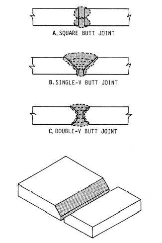

1. Butt joint
It is used where a single layer of metal or material is needed. Butt weld is nothing but welding if to parts of metal into a single part through edge to edge contact it is the most economical weld as it doesn't use any external elements
1. Butt joint

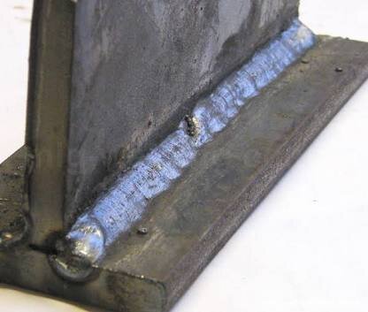

2. Fillet welding
Fillet welding is joining (welding) two pieces of a metal perpendicularly or at any desired angle the pic will give you a exact view on that

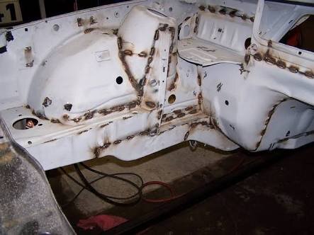

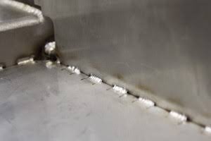

3.Stitch welding
Talking about the stitch welding, as the name indicates the welding is done in a stitching manner.just see the pic, they are used for connecting long welds where continues welds are not needed, it's simply implemented to reduce the cost of welding
And about fillet welding they are used for welding pipes and welding cross sections of infrastructure, and when fastening metal by bolts isn't strong enough and wear off easily
Oh.... bro stitch welding is used in areas where overall welding is not required for eg in automobiles to connect the parts they use stitch welding instead of full or fillet welding to reduce the cost
