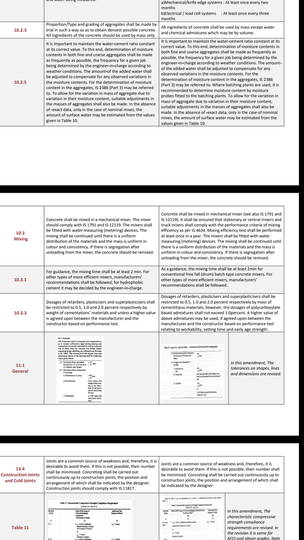

Vikas sharma Newbie Mumbai Nov 27, 2017 #2 Is 456 10.3.3 Attachments Screenshot_20171127-052536.png 927.5 KB · Views: 240 Reactions: VIDHYA SAGAR Upvote 0 Downvote
SAURAV26 Newbie kolkata Sep 17, 2019 #4 As per Is code for the use of admixtures, usually the qty. of admixtures (any) ranges from 0.2% to max. 5% of the mass of cement used. Reactions: VIDHYA SAGAR Upvote 0 Downvote
