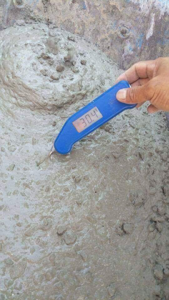

What is the name of this fresh concrete test and purpose
It's KNOWN AS TEMPERATURE TEST FOR CONCRETE.
PURPOSES BEING:
  1. The temperature measurement is typically done to make sure the concrete is in compliance with certain specifications that define a certain allowable temperature range.
  2. Typical specifications require the temperature of the concrete during placement to be within a range of 10°C to 32°C (50°F to 90°F).
  3. The temperature the concrete exhibits during placement affects the temperature of concrete during the next hydration phase.
  4. Monitoring the temperature of the concrete during phase III and IV is a quality control component that is regularly being performed
  5. The main reason behind this measurement is to ensure the concrete does not reach temperatures that are too high or too low to allow proper strength development and durability of the concrete
  6. Another reason for monitoring concrete curing temperature during this phase is to evaluate the in-place strength,
