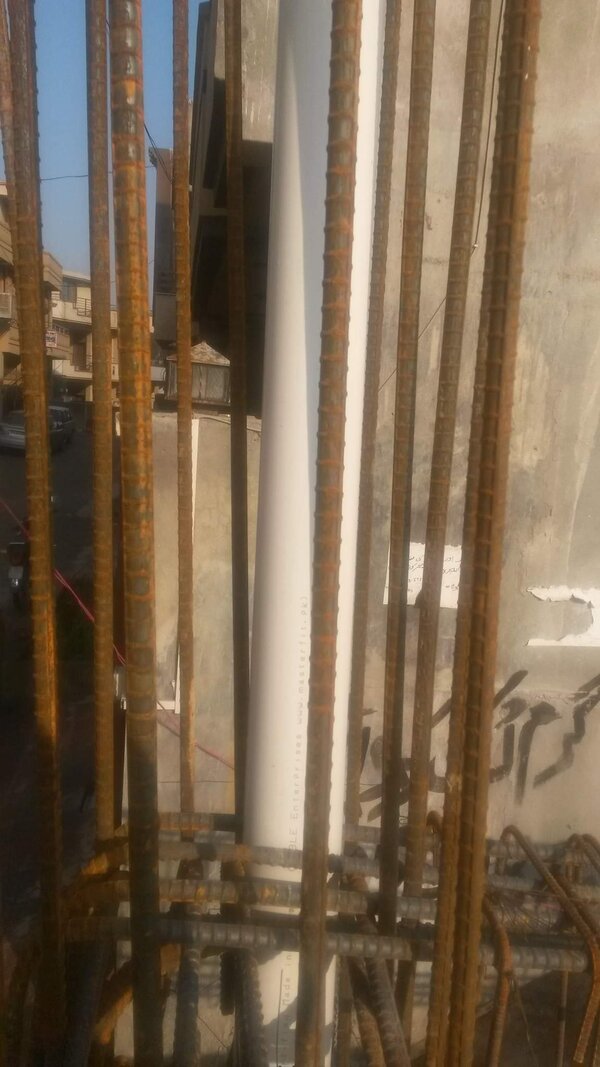

I think it is the wrong process to put the pvc pipe in between the column it leads to the volume of column concrete can be decreased as per the design strength of the column.
