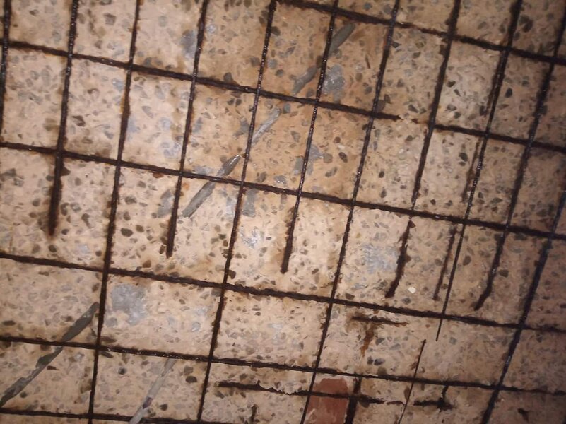

Slab covering will be less, such abnormality results after few years.
Plastering may not have carried out to protect slab from fumes and gases.
Some pipes are visible in slab, water may be seeped from this pipes and corroded bars resulting expansion of bars and bottom portion have detached.
