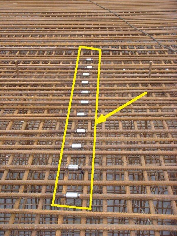

In technical terms, this is called as a MECHANICAL SPLICE.... or a REINFORCEMENT COUPLER
Mechanical means of splicing of reinforcement bars involve joining of two reinforcement bars end to end using a reinforcement coupler and is a relatively new method being adopted in some important projects.
Mechanical splices may be reliable under conditions of cyclic loading into the inelastic range and may also be advantageous at locations where inelastic yielding may occur.
Mechanical splicing of large diameter bars is often advantageous as this results in less congestion during concreting and faster construction. However, the condition and quality of the concrete and minimum clear cover requirements are to be ensured even in case of mechanical splicing of bars.
Further, the material of the reinforcement coupler should be compatible with the material of the reinforcement bar to be spliced and as well as with the concrete.
