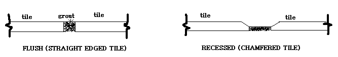

4. Chipped tiles should not be used. All ceramic and terracotta tile should be immersed in water 12 hrs before laying. Stick the name of the tile mason over the tiled area done by him.
5. For skirting using vitrified or ceramic tile the wall level and tile level should be flush with 4 mm pre groove. However avoid using cut tiles for skirting unless skirting tiles are factory manufactured and come with chamfered edges. Granite / Marble skirting is preferred.
6. Cure all tiling works and joint filling works for 3 days.
