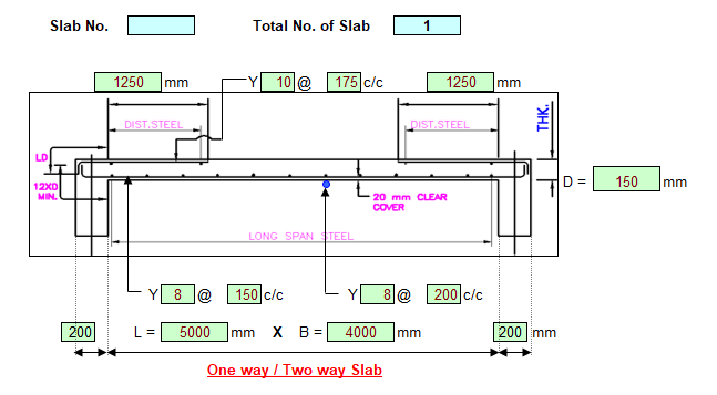

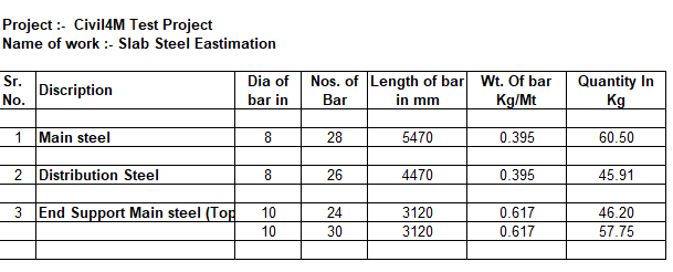

This simple excel sheet will help you in calculation of quantity of reinforcement steel required for slabs, just put the basic details as shown in above figure, it will calculate the steel quantity and show you in a table which you can print and file it for record.
This simple excel sheet for calculation of reinforcement steel quantity for slab is attached below. You can download it by clicking on attachment.
