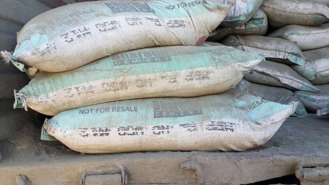

Printing of Manufacturing week on bag happens after bag is loaded with cement on a conveyor through which bags are sent either for stacking or directly in wagon (at company no one use iron hooks)
Printing is automatically done, so sometime you may get bags on which the manufacturing details are not printed correctly (Such cases you should inform the manufacturer about this and get the written confirmation from them via email before accepting it. This will also ensure the rectification in printing process and other engineers will receive bags with clear print on bags)
Also i would like to tell you that directly order bags have not for sale or not for retail printed on it. A bag having price written on it is produced for retail sale and you might get a very old bags if you order it through retailer.
Do not accept the cement which is more than a month old (Ensure you put this point in purchase order to avoid dispute in future).

Preserving the sample from each lot
A Sample of cement as received should be preserve in air tight bag or container with all details about that batch. this will help in solving the dispute in future which may occur due to failure of concrete at project and also help you to blacklist the manufacturer if he does not accept the failure.
Preserve sample will give you accurate result of actual manufactured cement.
Failure in concrete may occur due to many possibilities such as
Storage condition of cement at site.
Batching condition for concrete.
Cube casting errors etc.
Don't be afraid of Cement manufacturing companies, Mistakes may happen at plant due to carelessness of somebody (Chances are less due to advance systems and automation at plants, but human can make errors too)
Hope this will help you in checking cement, when you receive a next lot of cement at your site.
If you have any question on it or if i had miss something please do reply i will correct it. This will help engineers to do correct checking of cement.
Recently observed issue in OPC Cement Bags - Have a look at it, to ensure correctness in detailing. click on below link
