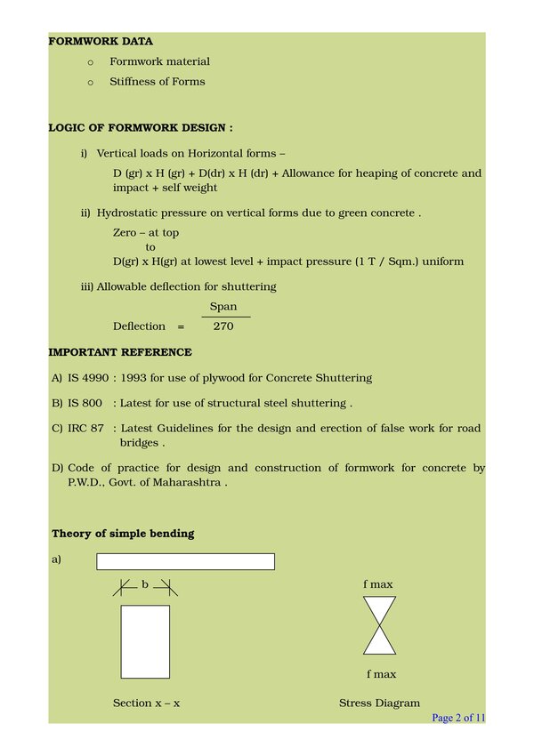

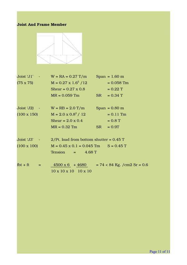

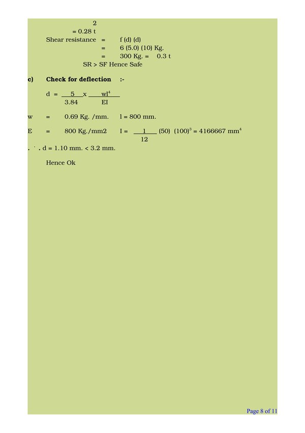

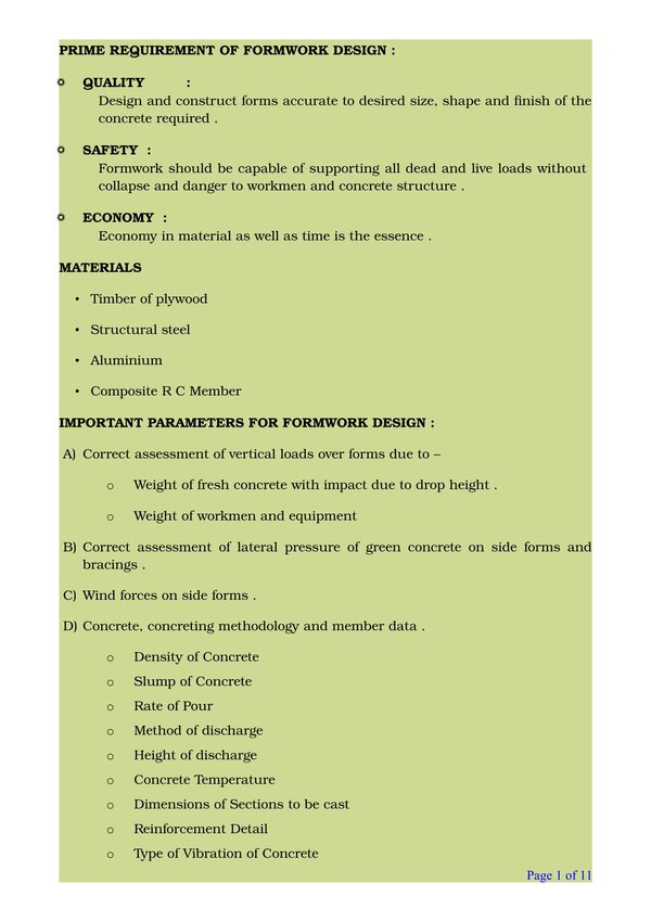

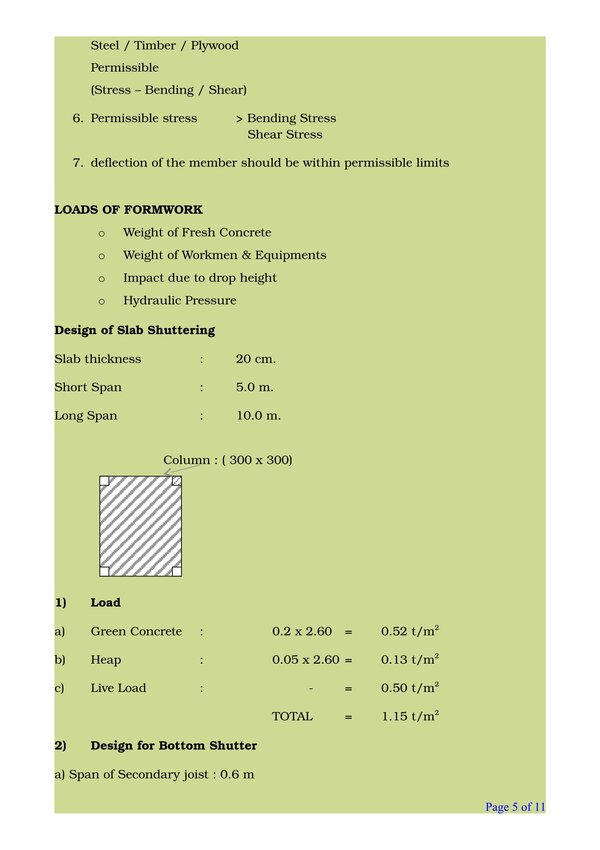

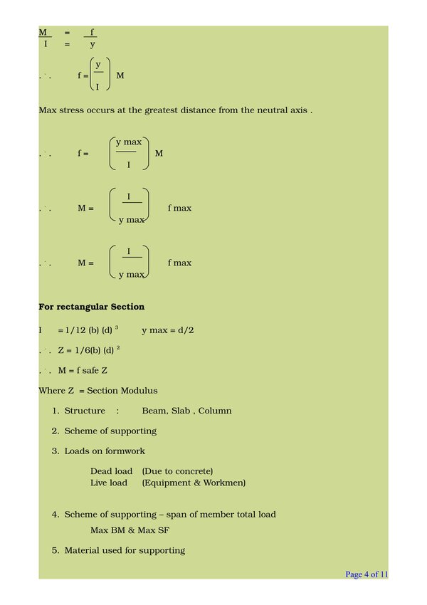

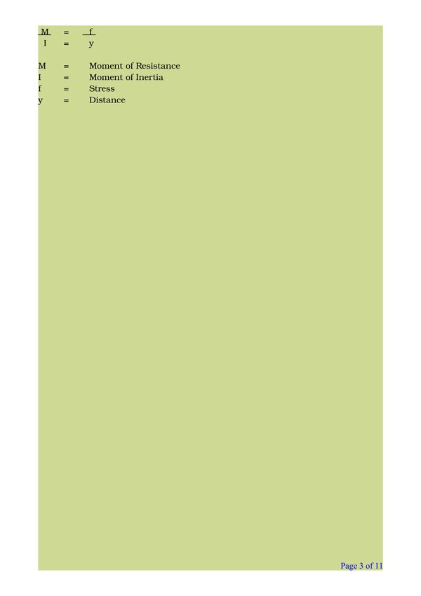

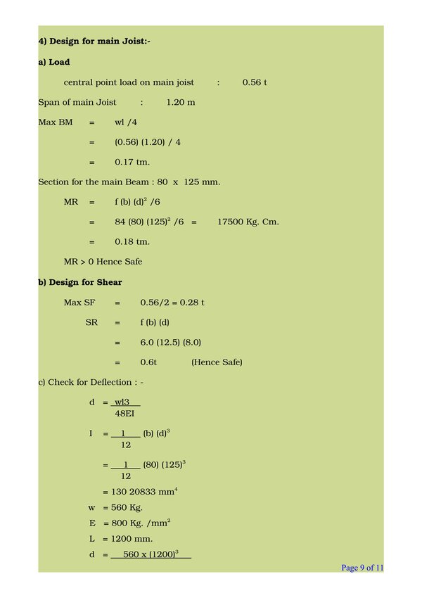

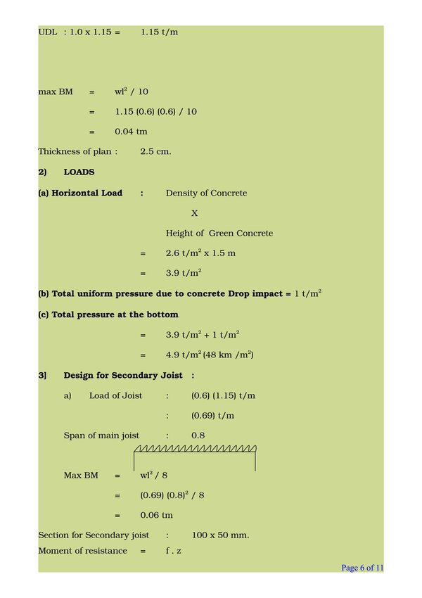

Srinivasan Prime CE mumbai Sep 19, 2017 #1 Attachments Prime_requirement_of_formwork_design-09.jpg 119.4 KB · Views: 310 Reactions: Jatin Taware and Arif
