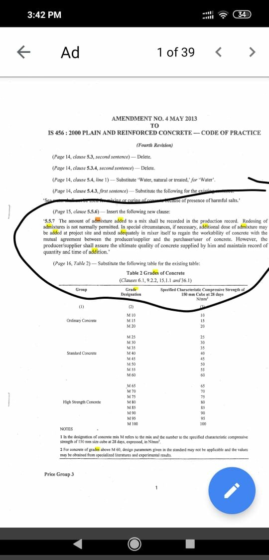

can you please attach the screenshot or position of location in pages in IS 456:2000 because I can not find the clause no. in book. So please update here.Please refer AMENDMENT NO. 4 MAY 2013 TO IS 456:2000 PLAIN AND REINFORCE CONCRETE CODE OF PRACTICE , clause no. 5.5.7
Thank you.
