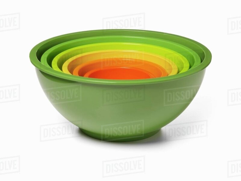

Thanks a lot for this information my friend.
I tried to used fibers but it seems to really made the mix not workable. i will buy a superplastizer and try again with it, thanks :)
The casting of 10-20 mm is usually the thickness of the end concrete bowl that is coming out of the plastic mold.
i tried to do ratio of 1 cement 1 sand 2 with but it was too rocky...
any suggestion on a different mix ratio with aggragate(without it i find my casting easily breaks)

What is the size of bowl diameter and height.
Are you using any kind of reinforcement in it like putting cage / mesh of MS or GI wire.
For doing casting like this when concrete is mixed, it should be stiff (almost no workability) then add admixture in it to gain workability which will make mix little plastic.
Put the mortar / concrete in mould and to make it compact use vibrating table, due to vibration it will get compacted completly.
You need to make trials with different combination to arrive at best.
Making flowable mix with water will always lead to low strength.
Less amount of water gives higher strength.
As i am not sure about what it is but imagining its not more than 100mm in dia and height.
