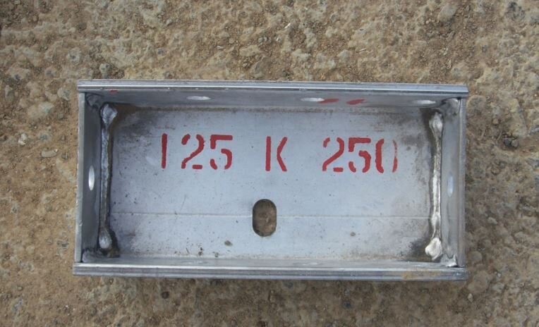

Kicker is a panel of 65 mm wide and 125 mm deep, it is most important panel in aluminium formwork.
Kicker is also named as Starter block
It is anchored in concrete and act as a ledge for the wall panels on the next floor to sit on.
It also forms the wall face at the top of the wall panel.
Kicker is basically a starter which keeps the walls and columns in position and does not allow it for movement.
It comes with slot of 25mm in it, to put M16 bolt generally 80mm long, which goes into concrete. After concreting, all kickers / starter block get rigidly fix into concrete surface due to bolt.

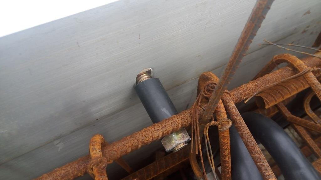

To ensure correct anchoring and no slurry loss, the bolt should be cover with PVC pipe and cone.

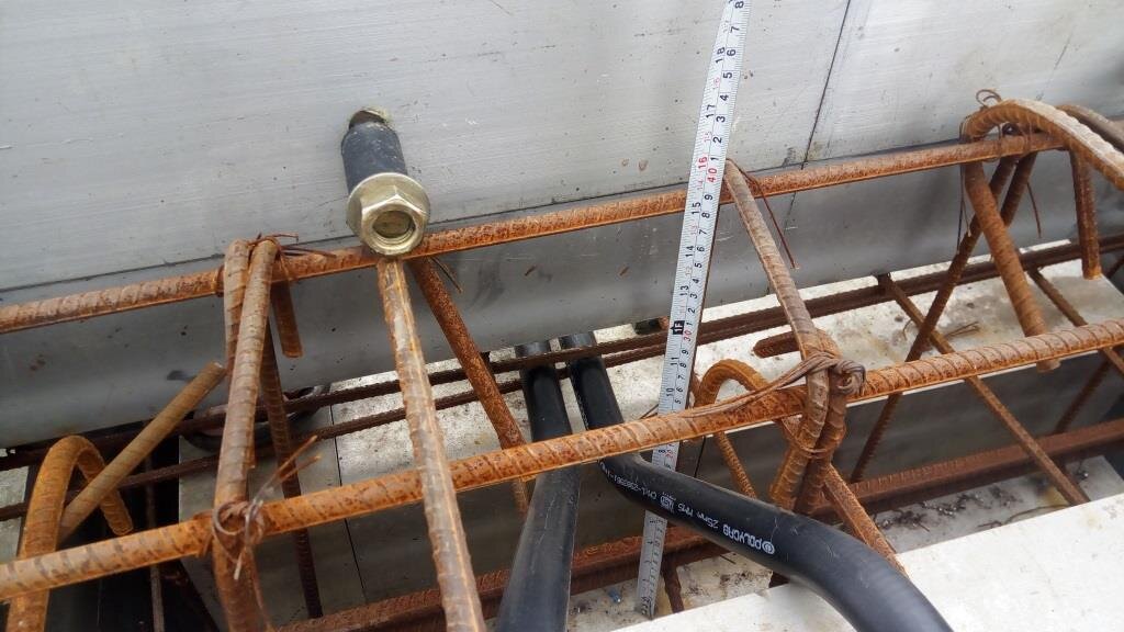

while placing reinforcement in position, it should be checked for integrity of kicker bolts.
There may be possibility of, to put kicker bolts beam height is reduced by worker. - this is all the way wrong practice and does not allow kicker to work correctly.

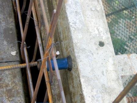

Below is the correctly placed kicker bolt photo.

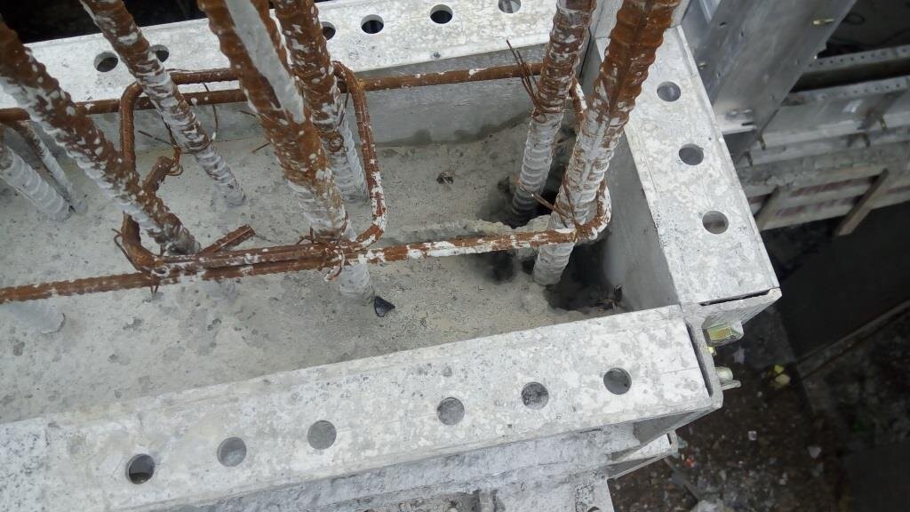

During concreting, it is must to ensure all kicker bolts goes into concrete, else it will lead to loose base and wall or column will easily get moves in next floor concrete and forms a offset in concrete surface.
