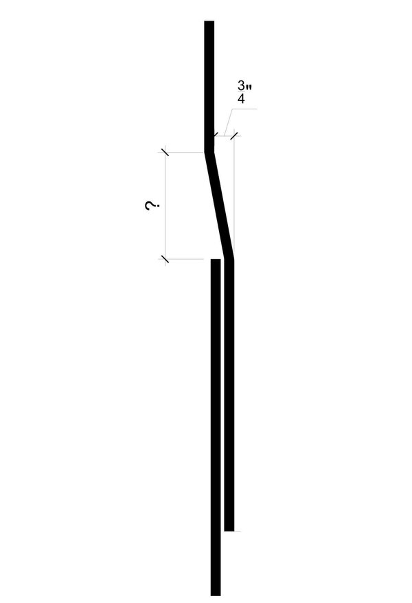

Can anyone tell me the crank length in overlapping?
rameshchandrapatel
Active Member
Crank is a slight bending in bars at the lap so that maintains the clear cover even at the lap position. The rule that is generally practiced is that the slope of crank 1:10 & minimum length of crank 300 mm.
Formula of Crank length = (d1+d2+5)*10mm
d1=diameter of smaller bar
d2=diameter of bigger bar
or 0.42 D with only one bar is cranked.
Reactions: HockeyPuck
In my 30+ years of road & bridge construction, I can't say that I've ever seen this applied, contact lap splices, even with large-diameter rebar have always been the norm. I guess I could see this type of detail being required in extremely tight or congested reinforced concrete elements where clear space between rebar is difficult to achieve.
