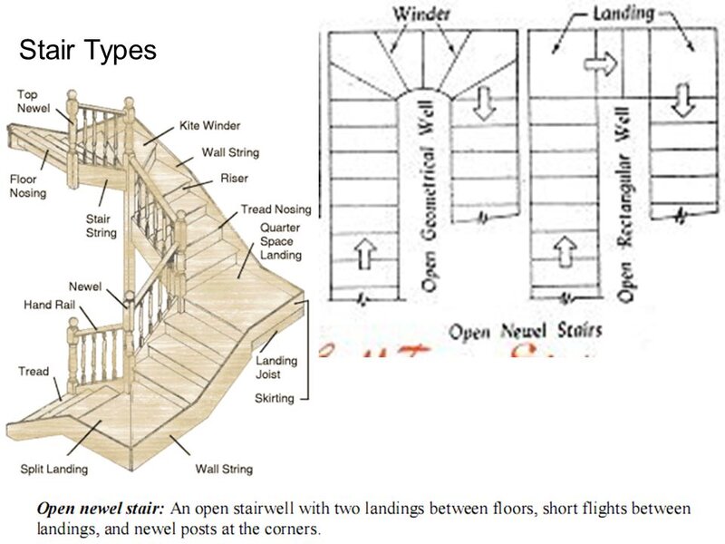

3. OPEN NEWEL STAIR:
This type of stair consists of two or more flights arranging a well or opening between the backward and forward flights. When all the steps are difficult to arrange in two flights, a short third flight of 3 to 6 steps may be provided along the direction perpendicular to the hall. Open newel stair is mostly adopted in the lift.

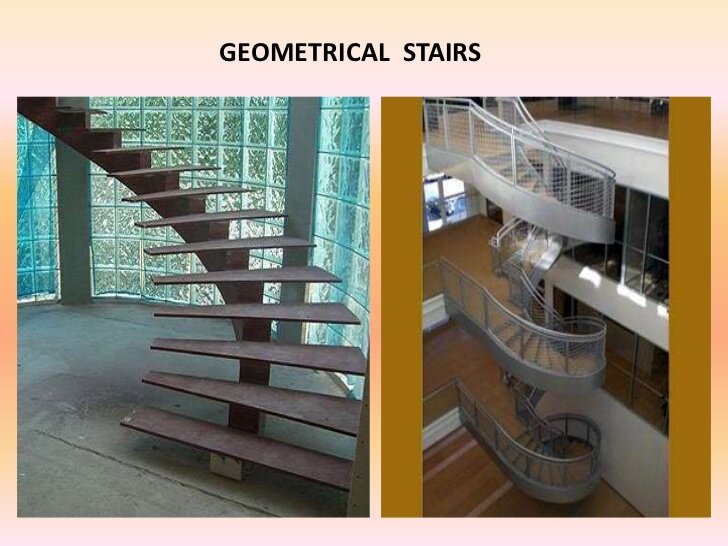

4. GEOMETRICAL STAIR:
This is another type of open newel stair where the open well between the forward and the backward flight is curved. This stair may contain different geometrical shape. Here the change in direction is achieved by using winders.

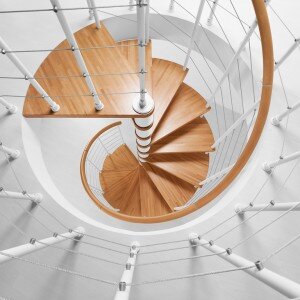

6. SPIRAL STAIR:
Spiral stair is very similar to a circular stair. It consists of individual steps or treads, connecting to a centre column. The overall diameter of the stair may range from 1 to 2.5 m.

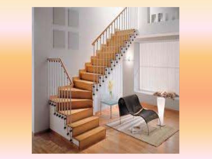

7. QUARTER-TURN STAIR:
The quarter-turn stair can be defined as the stairs that are turned at 90 degrees with the help of level landing.

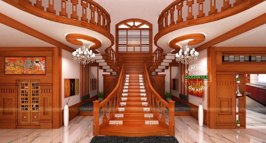

8. BIFURCATED STAIR:
This type of stair is provided in modern public buildings as well as residential buildings. In this stair, the flight is so arranged that there is a wide flight at the start which is sub-divided into narrow flights at the mid-landing. The narrow flights start from either side of the mid landing.
