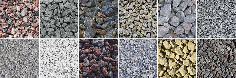

The Following are the some of commonly used stones:
1. Basalt and Trap: The structure is medium to fine grained and compact. Their colour varies
from dark gray to black. Fractures and joints are common. Their weight varies from 18 kN/m3 to 29 kN/m3.
The compressive strength varies from 200 to 350 N/mm2. These are igneous rocks. They are used as
road metals, aggregates for concrete. They are also used for rubble masonry works for bridge piers,
river walls and dams. They are used as pavement.
2.Granite:Granite are also igneous rocks. The colour varies from light gray to pink. The
structure is crystalline, fine to coarse grained. They take polish well. They are hard durable. Specific
gravity is from 2.6 to 2.7 and compressive strength is 100 to 250 N/mm2. They are used primarily for
bridge piers, river walls, and for dams. They are used as kerbs and pedestals. The use of granite for
monumental and institutional buildings is common. Polished granites are used as table tops, cladding
for columns and wall. They are used as coarse aggregates in concrete.

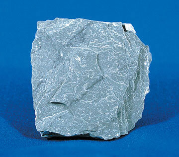

4.Slate: These are metamorphic rocks. They are composed of quartz, mica and clay minerals.
The structure is fine grained. They split along the planes of original bedding easily. The colour varies
from dark gray, greenish gray, purple gray to black. The specific gravity is 2.6 to 2.7. Compressive
strength varies from 100 to 200 N/mm2. They are used as roofing tiles, slabs, pavements etc.

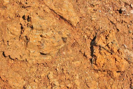

5. Laterite: It is a metamorphic rock. It is having porous and sponges structure. It contains high
percentage of iron oxide. Its colour may be brownish, red, yellow, brown and grey. Its specific gravity
is 1.85 and compressive strength varies from 1.9 to 2.3 N/mm2. It can be easily quarried in blocks. With
seasoning it gains strength. When used as building stone, its outer surface should be plastered.
