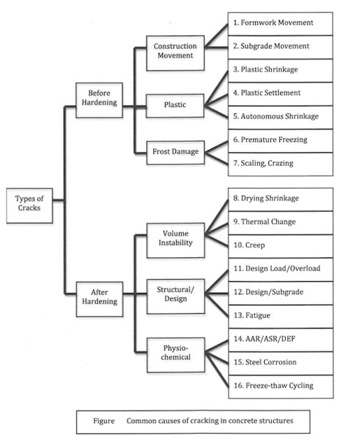

Types of Cracks in Concrete
The following figure shows types of cracks in concrete:
: 1505711323712.png
