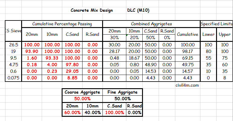

Just like PCC, DLC is done in Road works. Dry lean concrete is layed on the sub-base to get firm and level base for PQC or concrete road.

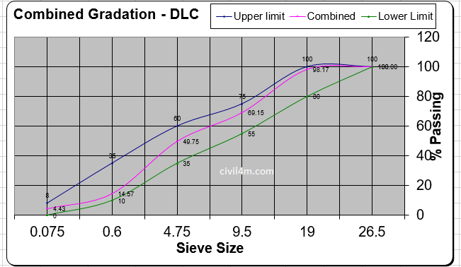

Combine gradation of aggregate is important parameter in DLC

Attached file consist of all test formats along with mix design of DLC
