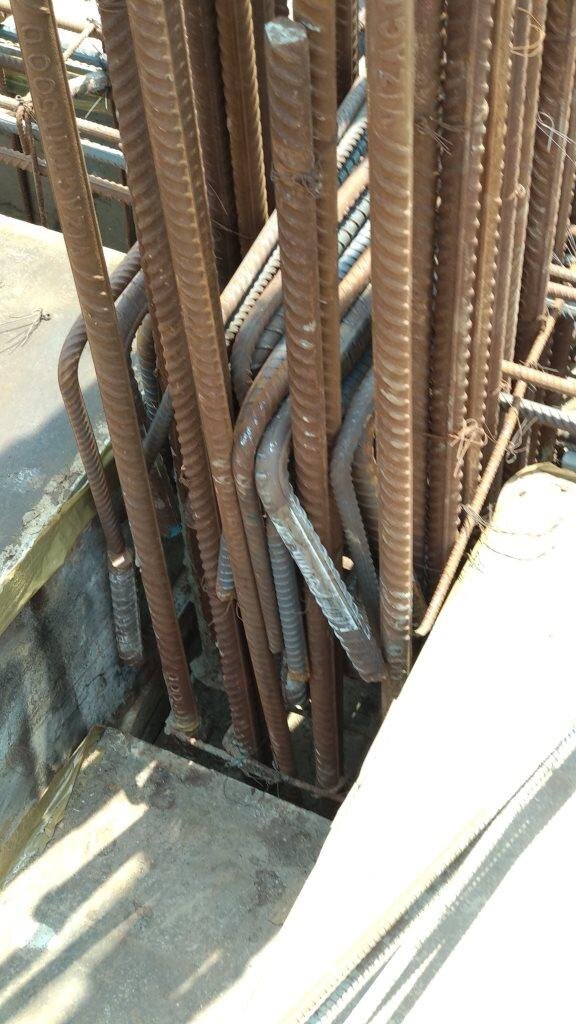

Sir what should we do at this column it very hard to flow concrete
Detailing of the reinforcement done in very wrong way. for a beam with width of less than 230mm, there should not be more than 2 bars in one layer.
Minimum gap of 50mm should be there between 2 bars of beam.
In above situation, you can get the solution for the same from Structural consultant by taking revised detail for particular beam or you can do Self compacting concrete (SCC) or free flow concrete, which will increase the cost of the project.
