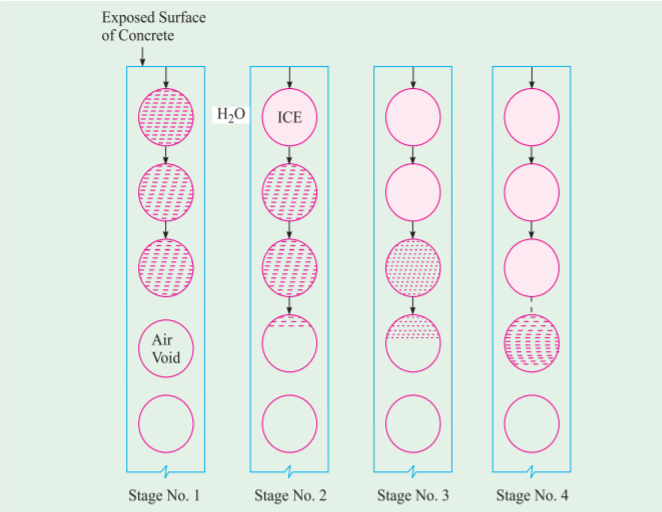

To allow / companset the effect of contraction, airated concrete is used.
So air bubbles inside in the concrete do really help it to protect its self from cold weather and expansion contraction cycles.
