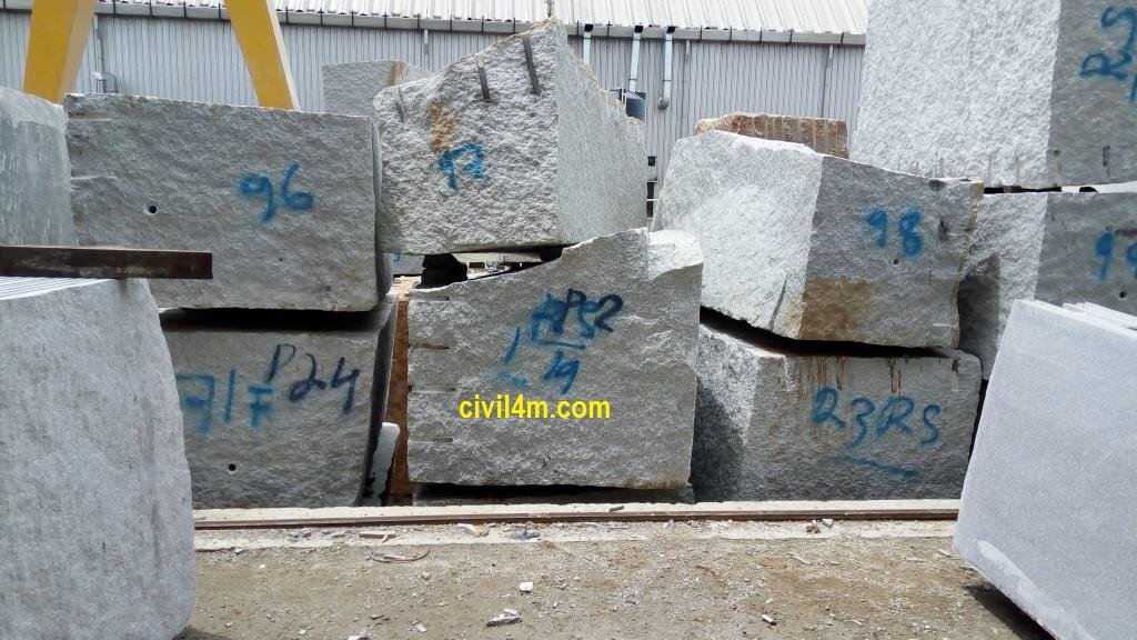

The granite stones are taken out in big size blocks which can be transported and cut to required size from rock or earth by blasting, cutting and other means of suitable methods.
The raw stone blocks then transported to factory for further processing.
When a truck load reaches at factory, Quality inspector does its inspection, for quality, Color properties and presence of cracks in it. After this a financial calculation are done on the data and truck load is accepted or the bargaining happens base on the properties of stone.
Once the lot is accepted, it is unloaded with the help of gantry cranes.
As the stones is natural material, there will be variation in properties of stones and mostly those people are interested in color and texture properties of it, according to properties stones are stacked for cutting. Same lot of stone can have different types of granite slab which can be sold at different prices.

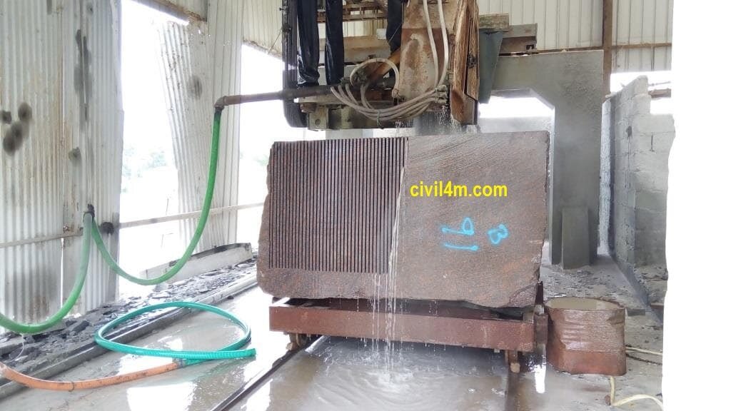

The stones are then shifted one by one in cutting area, where stones are finally shaped into a slabs with thickness between 16 to 25 mm.

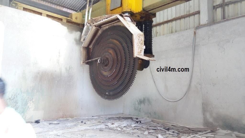

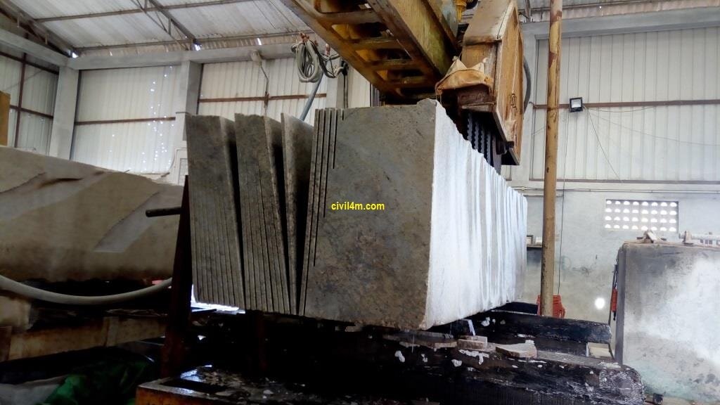

In most of the factories cutting of stone done with assembly of 4 blades, which cut stone blocks into 4 slices of specified thickness at different levels to avoid breakages and damages to it. During cutting water jet is also used at cutting location to prevent damages to stone and blades.
The cutting of stone can be done either in full body or by keeping some portion of stone block left uncut.
Cutting in full body gives you more quantity of slabs but may lead to damaging blades which increase the cost of maintenance.
If you keep some space from bottom, and left some stone, this keeps slices of slab in position and reduce the risk of blades getting damaged.

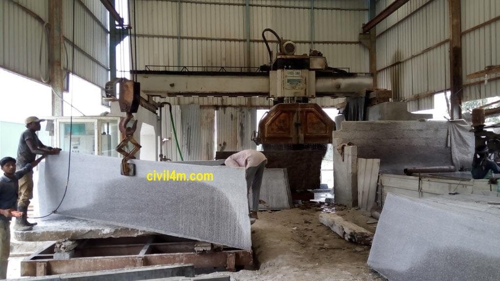

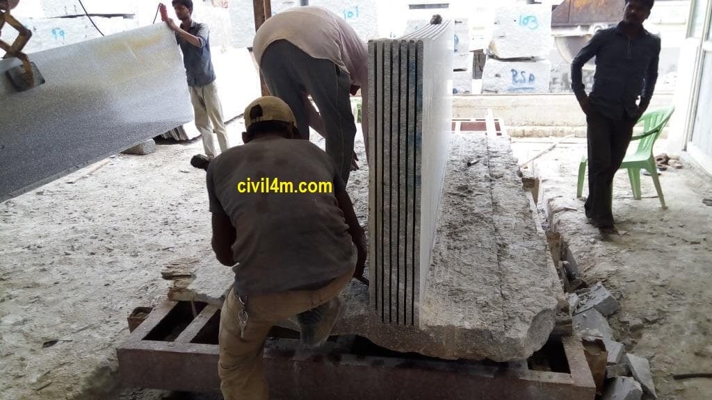

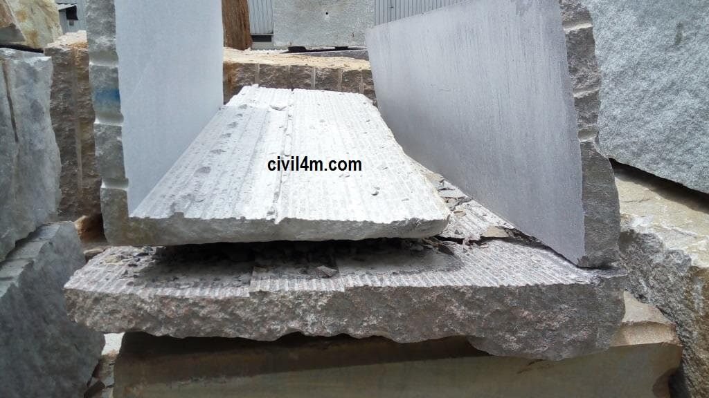

After completion of cutting stone block, it shifted to other location to break slabs from base body, in case block is not fully cut till bottom.
After removing each slab from body, then it is shifted to stack yard near polishing machine via gantry cranes.

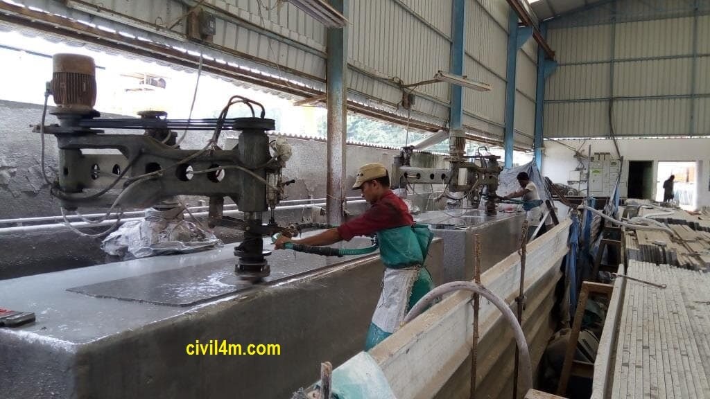

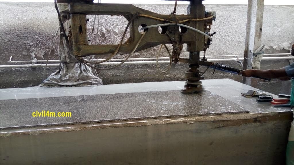

The stone slabs are then polished with polishing machines and different kinds of polishing blades.
Water jet along with movement of polishing blades used to avoid, dusting and damages.

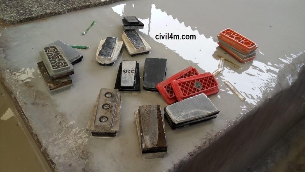

Below is the photo of different kinds of polishing stones, was seen at the Factory.

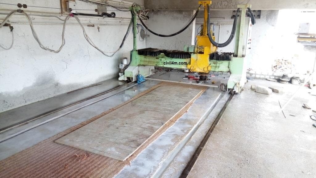

Polishing on granite stone slab is also done with fully automatic machine, where no human interaction happens other than placing and lifting slab from polishing machine area.

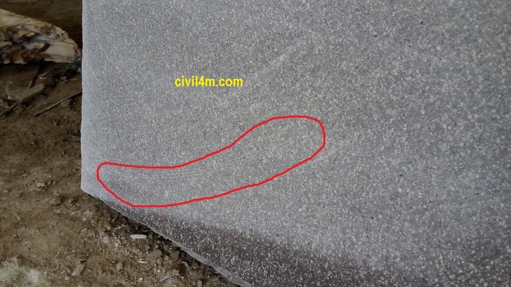

During cutting if there is slight movement in block, the polishing blade marks get embossed on slab due to scratching of surface. This is a unavoidable defect which can’t be seen from a distance, but if you take closer look of slab, you will find some scratches on granite slab.

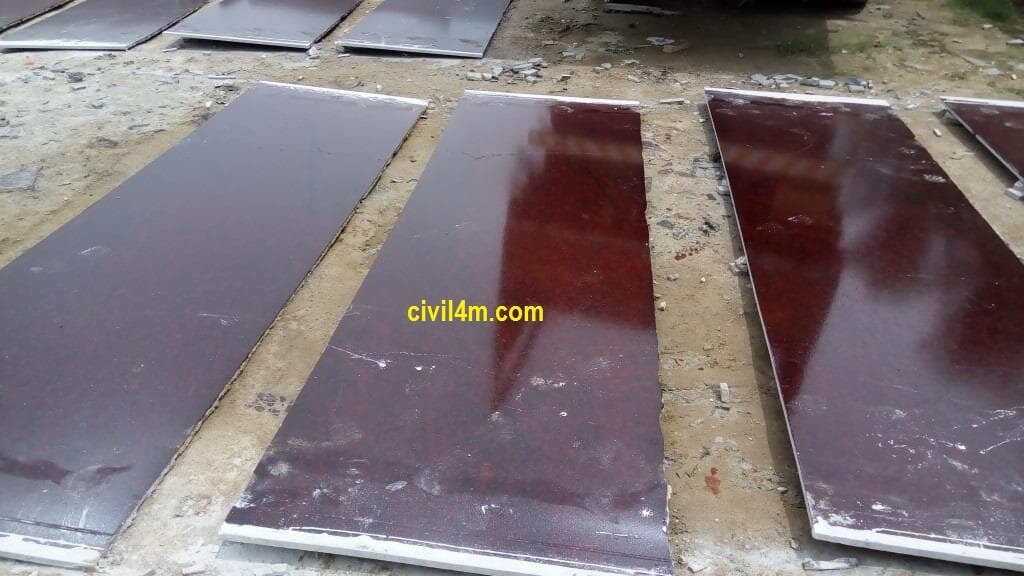

After polishing of granite slab, shiner is applied on the polished surface of granite to make its texture and color brighter. Those effect can go long term if slabs are used under sheds but may become dull if slabs are under direct sunlight. There also other parameters which can make granite slab surface finish dull over time.

why different polishing stones, are used in manufacturing,,
also you said about defect due to blade
can u provide some details about water mark coming on granite which is also a defect ,where this came from ,how water mark are coming on granite ..
although information provided here is very good ..@Dnyan Deshmukh
Thank you
Reactions: Rohith Rao
granite-scratches-jpg.1709
This Pic shows a defect on cut stone slab surface.
I don't have much idea about it but it may be like same thing how we sand wall surface with different grades sanding papers to make surface smooth.

The blade marks on granite surface get minimize during polishing activity. few can be still seen on some type of granite's when you do very close inspection of it.
In most of the cases, those are not visible from distance, under shed and in dark areas.
