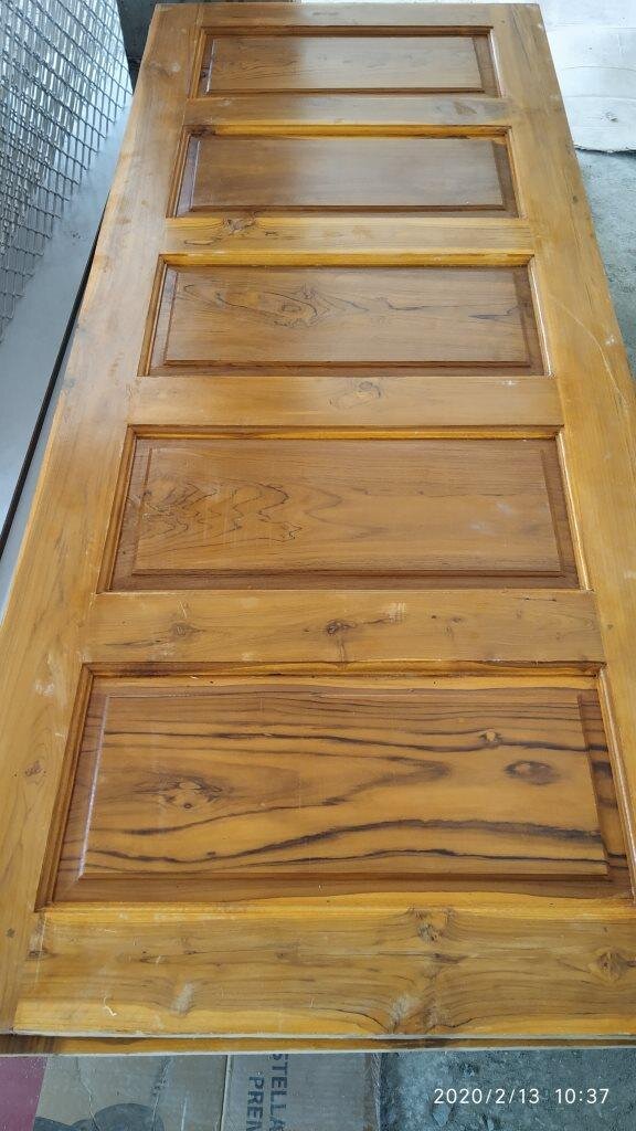

Question How to confirm material and check quality of teakwood door shutter ?

Following basic test at site
Check the Dimension ,corners of shutter,
Surface should be uniform
Gentle Knocking should produce even sound need to check for void.
Clean surface of shutter with wet cloth to check varnish quality.
