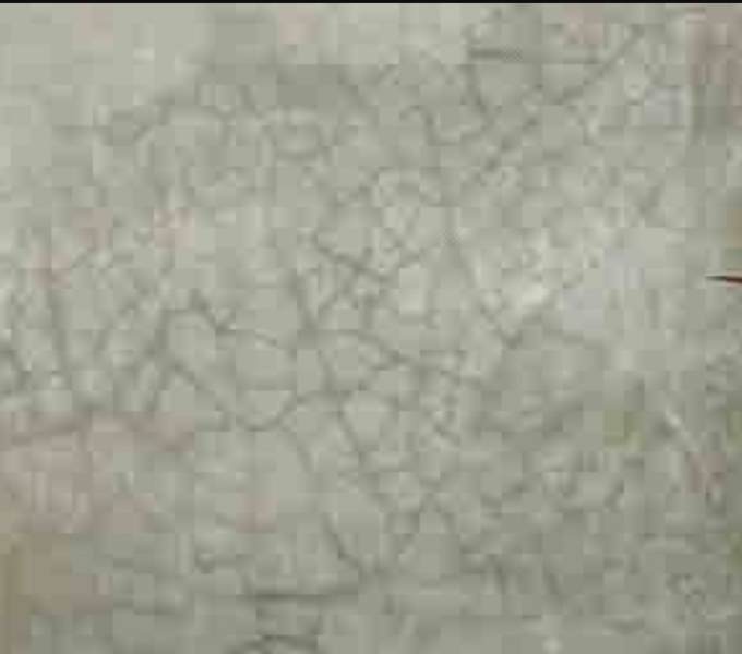

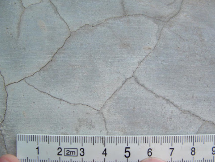

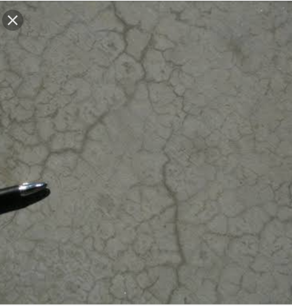

It is occurring in the external sand face plaster
Sort by date Sort by votes
  • Dec 3, 2017
The photograph clearly indicates
high silt sand is used and also the dry cement is sprinkled during plastering.
you can find detailed answer at below thread which was again created by you.
https://civil4m.com/threads/why-crazing-in-plaster-occurs.1205/#post-2976
Kindly do not make multiple threads of same questions.
