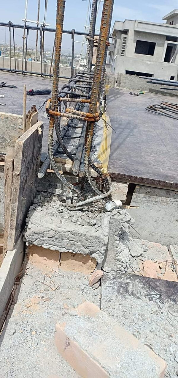

archdevil Royal Member India Apr 11, 2019 #1 Is column reinforcement bar joggle like this is acceptable?
Dnyan Deshmukh Staff member Pune Apr 14, 2019 #2 No absolutely not, your column is made up of brick layer above beam. In case of unavoidable situation joggling of bar should be one in ratio of 1 inch in 2 foot. Reactions: Muzammilh64 Upvote 0 Downvote
