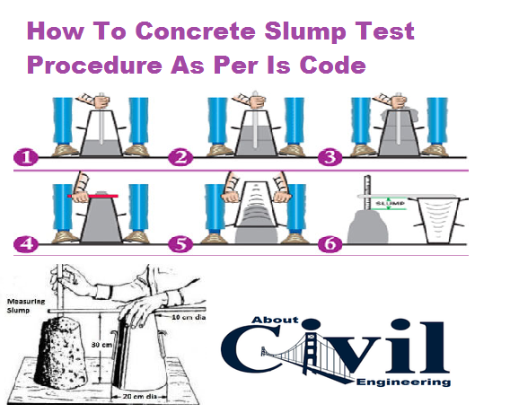

All I seen a technicians place a Metal CONE adjustcent to the concrete.. And place a T-SQUARE On top and measure from Top end of CONE to TOP end of concrete sample.
