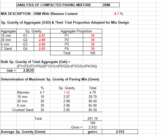

Chetan Yadav Staff member Aug 6, 2018 #1 Marshal Stability Test on DBM with Example Marshal Stability test format along with different content of bitumen binders are attached in this thread. You can download and understand how this testing is done. All test conducted are detailed in attachment, download it from below. Attachments MARSHAL STABILITY.xls MARSHAL STABILITY.xls 24 KB · Views: 347 MARSHAL STABILITY-design-AC-5.5.xls MARSHAL STABILITY-design-AC-5.5.xls 54 KB · Views: 311 MARSHAL STABILITY-design-AC-6.0.xls MARSHAL STABILITY-design-AC-6.0.xls 49.5 KB · Views: 322 MARSHAL STABILITY-design-AC-6.2.xls MARSHAL STABILITY-design-AC-6.2.xls 31 KB · Views: 293 Reactions: rameshchandrapatel
