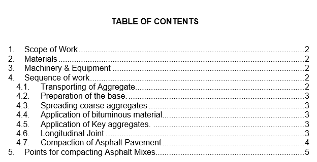

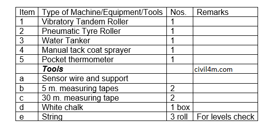

The equipment to be used for laying and spreading of BBM shall be Tippers, Motar Grader, vibration tandem roller, pneumatic tyre roller, Bitumen boozer and water truck as and when necessary.

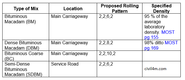

Compaction of Asphalt Pavement
The sequence of rolling starts with the compaction of transverse joint at the starting of the day’s work. Where paving is being laid in more than one lane the next step is to roll the longitudinal joint in the manner as rolling the transverse joint. After the longitudinal joint the rolling should start at the outer edge, and the roller drum project about 5 to 10 cm outside the edge. In super elevated or cross-fall, the rolling shall proceed from lower edge to the upper edge or in this case the center median.
Initial rolling temperature of the mix shall be in the range of 115 to 135 degree Celesius. A trial lay shall be conducted for the paving and determination of the rolling pattern of the mat.
The rolling pattern as mentioned below 2,2,8,2 shall means that the initial rolling will be 2 passes follow by 2 passes of vibrating, 6 passes by the pneumatic tyre roller and finally by the tandem roller to erase the tyre marks.
Initial rolling 2 static passes shall be rolled by means of vibratory compactor (twin smooth drum tandem roller) follow by applying 2 passes of vibration compaction. When vibratory roller is used for compaction of bituminous material, vibration should be cut off before changing direction of travel, to avoid marks on the surface and prevent shear or slip on the mat. The maximum speed for smooth wheeld roller is recommended as 5 km/hr and the speed of pneumatic tyre roller shall be 10km/hr. the roller drums/tyres shall be kept moist to prevent pick up of the hot asphalt mix.
