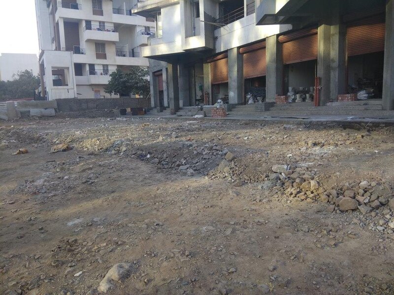

Need suggestions on how to fix paver blocks along the Road side
First of all, you need to do the compaction completely where paver block need to be installed.
Then in order to ensure there is no movement of blocks after placement, you need to cast a 200 mm band of height in level with paver blocks atleast on three sides of the total area where paver blocks need to be installed.
Do the bed preparation in lean mix, you can use crush sand along with cement for bedding (in case of services running from below, you can prepare a bed of only crush sand).
In case of combination of paver blocks and patterns to be made in it, you need to install line threads for alignment.
Do start installation from one side in L shape and proceed to other end same like flooring (you can use cement slurry / paste to fix blocks in position or you can lay dry in case services are running from below and want those blocks to be removed for maintenance.)
You can also find complete procedure in Work Procedure section at Forum. in case you do not find, you can request for it, might someone will help you on that.
